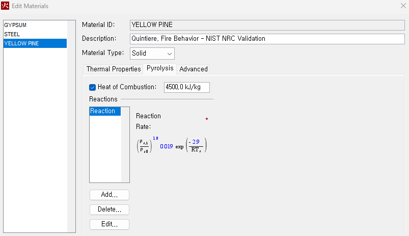

WARNING: SPEC REAC_FUEL is not in the table of pre-defined species. Any unassigned SPEC variables in the input were assigned the properties of nitrogen.
WARNING: MATL YELLOW PINE, REAC 1. No product yields (NUs) set
ERROR: SURF Wood cannot have a REACting MATL and IGNITION_TEMPERATURE (CHID: 23_05_19_Wood_A,E)
ERROR: FDS was improperly set-up - FDS stopped (CHID: 23_05_19_Wood_A,E)
[runfds.exe] subprocess exit: 0
Files with pyrolysis applied will not be parsed, and files without pyrolysis will be parsed. How can I fix this?

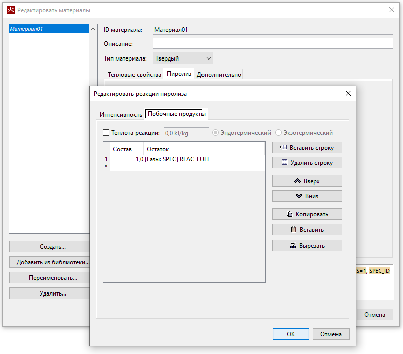

Re: Wood pine thermal degradation
Hello.
On Pyrolys tab you should select Byproducts tab and set fuel gas production:
Also if you use pyrolis, you shouldn't set Ignition Temperature in Surface.
